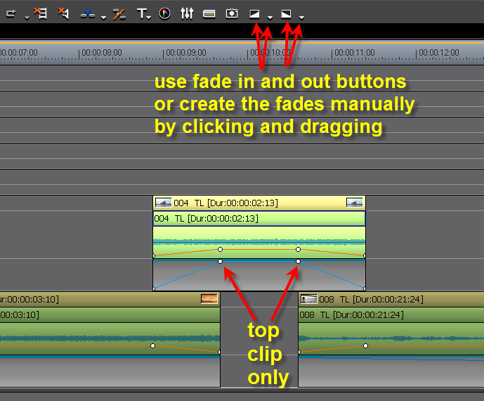

  • antonsvideo
    Originally posted by rudyds10 View Post
    The problem I encounter is that when I apply a transition effect between two stills manipulated with 3D PiP the systems does not behave as expected. In fact the first 3D PiP is applied to all the stills after the first.
    Anyone experienced the same, and more important, anyone knows how to solve this ?
    Thanks,
    Rudy
    some people love this feature, others don't
    to overcome, edit in AB style fashion by applying rubberband opacity dissolves
