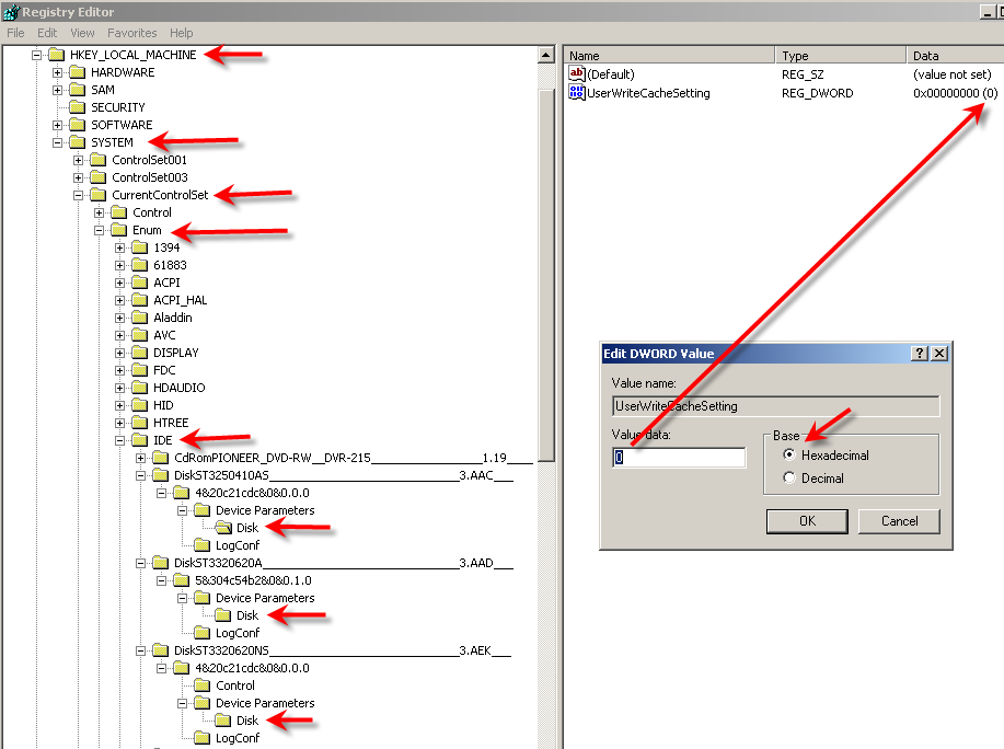

                          to disable write caching when it is grayed out in Policies menu
                          1. start, tun, type regedit
                          2. expand folders as seen in following link
                          3. set value of each drive to 0
                          0 = write caching off
                          1 = write caching on
                          4. reboot when done
                          5. verify that write caching is no longer grayed out and is off
