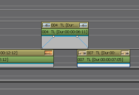

                  what transition do you wish to add in between 2 or more 3D PIP clips?
                  if dissolve, than this can be done easy with the keyer rubber bands
                      http://www.videoproductions.com.au/e...transition.gif
                      I was wanting to do a transition other then dissolve.
