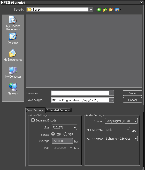

    elementary stream is one step ahead of program stream, you will not get an a/v sync issue
    most authoring software requires elementary streams, and those that do not, will demux the program stream to elementary stream during VOB creation
    a VOB is capable of many audio and subtitle streams, as a result video and audio should and must be separate
    btw, ProCoder2 does not create ac3, you need Procoder3 for that
    also, you can export direct from Edius timeline to mpg with ac3 audio included

    why would you need to change authoring software?
    all authoring software must support ac3 and elementary streams
    which version procoder do you use?
    even Edius 4.61 allows direct export to mpeg program stream with ac2 audio included (no need for Procoder), I see you have 4.61
