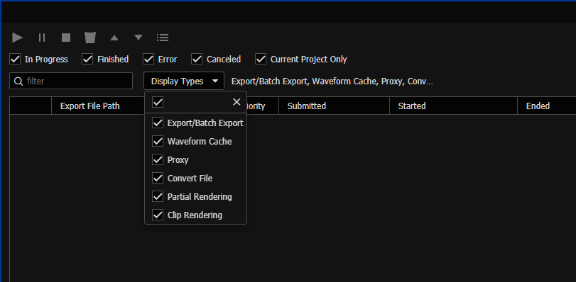

      Hi Anton, at the bottom it just says "registration". It does this everytime. I opened up a different project and it does the same. Please see new attachments.
        the status says waiting, so maybe there are still things rendering, you will need to show all render jobs to see if anything is still running
        and also check the main job monitor from windows taskbar as this holds jobs from all projects, the socked job monitor and the one from the EDIUS taskbar only display jobs from the currently open project
          Hi Anton ISSUE FIXED: My USB 3 hard drive was plugged into a USB 2 port. Must have deactivated render clip? All is good now. Phew!
