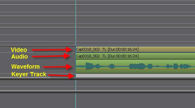

                    as clearly seen by your timeline screen shot, your video clip is missing the audio clip
                    here is a screen shot of a video clip that has audio and is showing a waveform

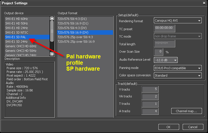

                    also, as seen by your project settings, you are missing the storm drivers, I can only see OHCI

                        Steps:
                        1 reinstall Edius.
                        This will install the lastest storm drivers.
                        2 Now you will see storm hardware presets in the preset list.
                        3 Select a storm preset for your project
                        4 Put a clip with audio on the time line
                        (because it is impossible to get any audio out if there is no audio on the timeline)
                        If you select an ohci preset there is no way you will get audio out of the storm.
                        You need the have a storm preset out of the storm.
                        I also want to bet that you get no video out of the storm also because the drivers are not installed.
                        Really simple no drivers for the storm = No working storm because xp will not know what to do with the device.
                        Hope this helps.
