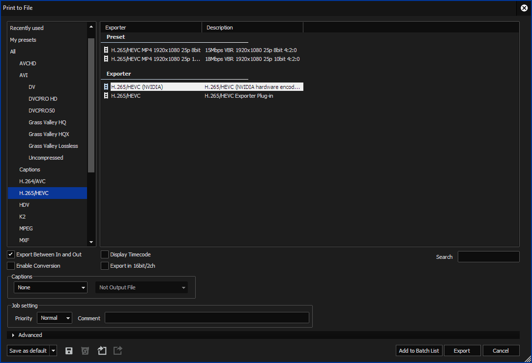

        Can I see a screenshot of your H265 export section? Does it look like mine? make sure your project is set to progressive
          https://www.videoproductions.com.au/EDIUS-X/H-265.png
          Screens with errors, project settings 1920x1080 25p
