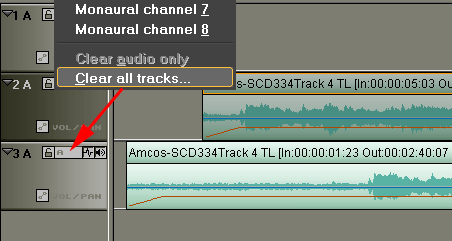

        on the left of any VA track, you will find what you need
        I have an old screenshot from Edius3 but it is similar in 4.6, you will find it
          here is a screenshot of 4.6 (due to the color scheme of Edius 4.6, the little a is hard to see)
          you can also press 9 to clear all tracks
