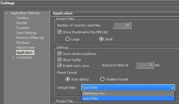

    My englis is not the best.....change my german edius Ui to english UI ... therefore pict. they are international
    when you press in the above "pull down" from the timeline >T<
    the marked collumn "Quicktitler" ... it will not open the Quicktitler Window ???

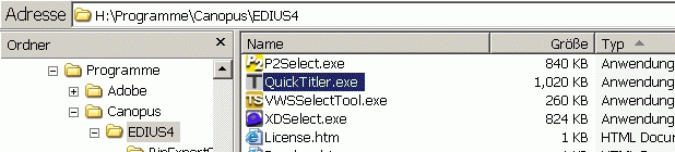

      when Edius is opening, and you go to the above marked QT.exe an double click it
      Quicktitler will open or not ??

        Yes Quick titler opens in the Edius directory. It opens in the bin window but it does NOT open in the timeline window.

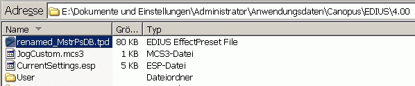

                    other shoot in the dark from the "titler-hole".....
                    repair and re-install do many things, but not changing the "user data"..... maybe it looks therefor eventually for a "corrupt-user"
                    you can (without risk) rename the >MstrPsDB.tpd< ... attention it is a (from windoof) "hidden" file\folder...
                    the path can you see on the folowing picture.
                    ___________________________________________
                    after rename >> start Edius >> save the project >> closed edius >> it is new (and default) written from Edius himself.
                    exampel-picture from about the above written procedure....
                    maybe it would help, or help to isolate your problem
                    per rename the >renamed_MstrPsDB.tpd< to the original name, you coming back to the starting situation
                    (logic ... the (for test) new written >MstrPsDB.tpd< move to a other folder, or delete)
                    excuse my "gibberish" english ..... friendly greetings from europe\austria\vienna....old (but not dead) Hans
