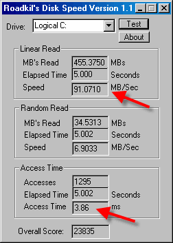

                        what is your video hard disk setup and diskspeed? www.roadkil.net (free diskspeed software)

                          I ran the disk speed test. From my video drive I got:
                          Linear Read 379.9375
                          Random Read 20.463
                          Overal Score 11136
                          I have my video drive as an external eSATA drive. The drive is a 500gb 7200rpm drive. I initially thought the problem was because I initially had the project on a different eSATA drive that was over 90% full. I just got a new set of eSATA 500gb drives and moved the whole project to brand a brand new drive. The files are now on a brand new, newly formatted drive. Everything is on a single drive. No RAID. I have been using this setup on my other computers for over a year and have not had this issue.
                          I tried setting my buffers to 128 like you and it still stuttered...just sooner and the clip that went red was the actual clip it was on. It is looking like a buffer issue. Today I tried to remove the RAM and replace it with some RAM from my other computer. Turns out they are different types and don't fit the slots. I thought they were the same. Guess I can't test that way.
                          I tried running a SD project from an archive drive and it still stuttered as well.
                          Is it possible that the Intel Speed Step in the bios could cause the problem? I have disabled it in the bios to see. Also are there any disc or memory related bios items that could be causing the issue?
                          I'm game for trying other things if you have any other ideas.

                            before we can go on, I need to see the speed test result of the third line down as seen here, and of the second last line
                            I need to see the results of the C drive and the video drive
                              Here is a link to the actual screen for you.
                              C: Drive: www.frogmanproductions.com/uploads/Disc_C.jpg
                              E: Drive: www.frogmanproductions.com/uploads/Disc_E.jpg
