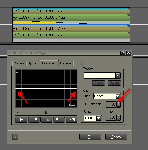

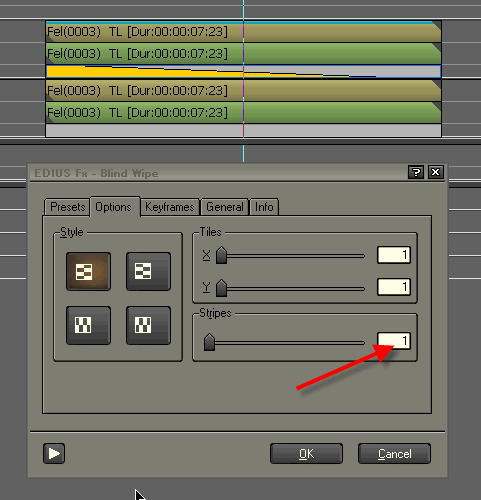

          another way to compare video quality is to do a 50% wipe and hold the blind wipe, and stretch wipe on keyer track to full width of clip
