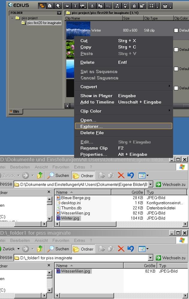

                        eventually simple way, eventually faster, and imho more control chances
                        create in windows the file i.e ...."_folder1 for **** imaginate" on hold it open
                        create in the bin a new folder i.e. ..... "**** first 20 for imaginate" and open [activate] it
                        a) on your timeline mark the different 20 pic and move it in one step per mouse to the new open bin-folder
                        b) sent the different 20 pic from your timeline per shotcut "Add to Bin" to the new open bin-folder
                        in the new open bin-folder right-mouse click[kontex] on a clip, and keybord "x"
                        will open the correct windows-folder from the media-file and mark the media-file
                        move [or duplicate] the marked file from one to the other open window folder with the mouse
                        exampel (look at the name from the folders):
                        greetings from europe\austria\vienna....old Hans
