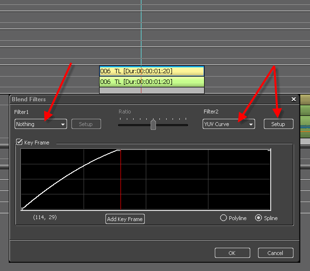

    When you zoom out and the camera is in automatic, the sensor capture some of the white sky and the frames getting darker. I watched the Edius tutorial "Color Correction with Keyframes" and tried to apply the same in YUV Curve. I can not find the option between the keyframes to slowly fade in. Meaning to say, when the zoom out starts, the brightness should gradually increase. When I set the keyframe, at that point it enables the new setting. How can I make it gradually?
    this is currently broken in the YUV curve filter, but don't worry
    use the blend filter
    you can have YUV curve as a start and end filter, both with different values
      yuv keyframing is still broken in version 5... :(

        As already covered several times in the past, this is how it was designed. So really, what you want to be saying is "my request to have it changed to how I like it, has not happened in this version"
        I believe it's a thread in the feature request forum.
