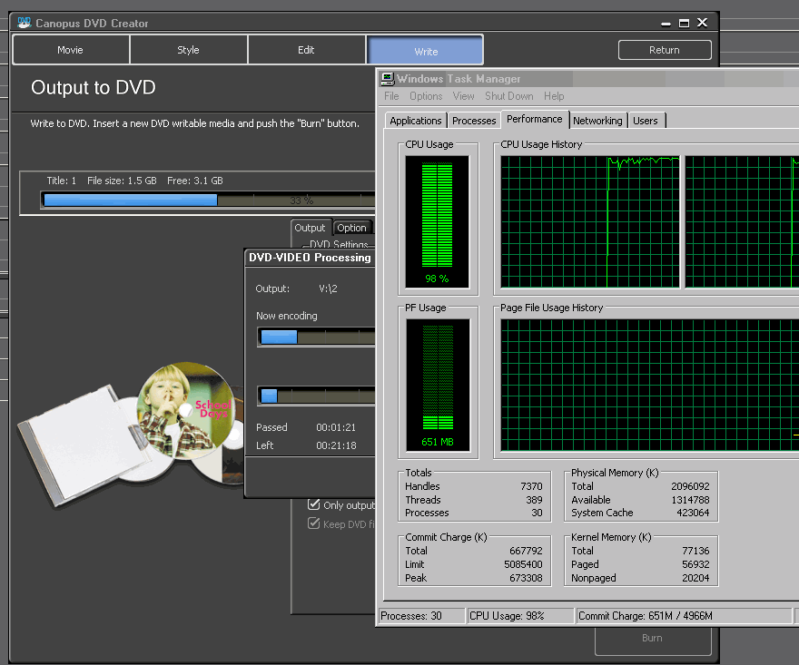

                            • #29
                              I turned off hyperthreading
                              now DVD creator is fast and uses 100% of processors
                              http://www.videoproductions.com.au/e...eading-off.gif
                              but ProCoder and PCE and Tmpeg4 are way slower now
