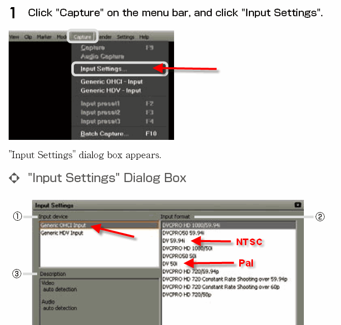

before you can press F9 you need to go to input settings and choose DV pal or DV Ntsc

I took a screencapture of the manual (which has poor quality images) and enhanced it with red arrows, this will give you the idea of what you must do before you can use F9
http://www.videoproductions.com.au/e...dv-capture.gifAnton Strauss
