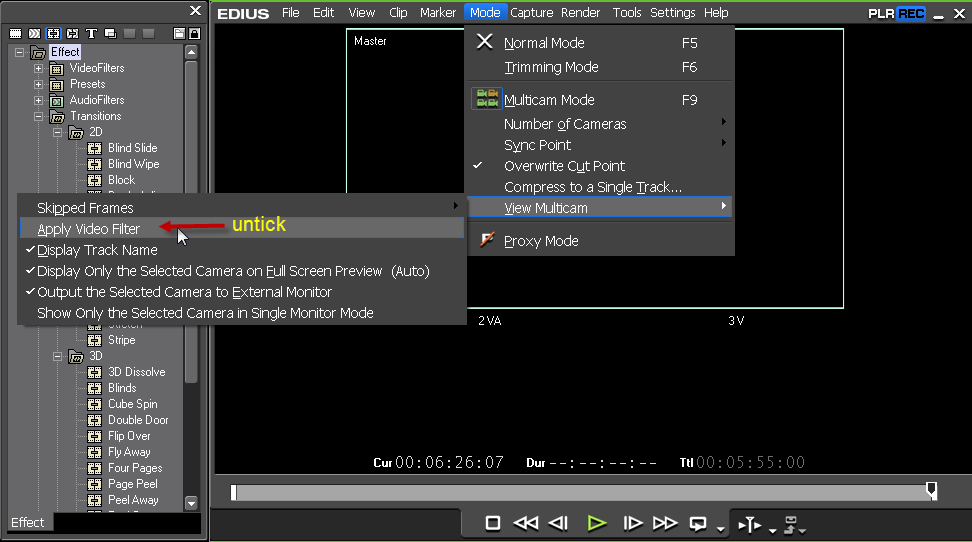

    there should be a huge performance differenec by unticking this option while in multicam, as soon as you exit multicam, all filters kick in and do their job
    you must have a very powerful PC to handle 12 cameras UHD in multicam with filters enabled, mine can't do that

    I use 9 pro. I changed nothing on the settings after update. It is possibble that the update changed something but I don't think. I tried to switch off the filters while in multicam mode, it doesn't helped.
    I always use the show filters, the pc can handle it at 12 cameras too. Usually I use just stabilizator and sharpness effects, and rarely the primary color corrector (not on all tracks at sthe same time).
  • antonsvideo
    are you using 9 Pro or 9 WG?
    have you disabled the use of filters while in Multicam? a must with 9 cameras
