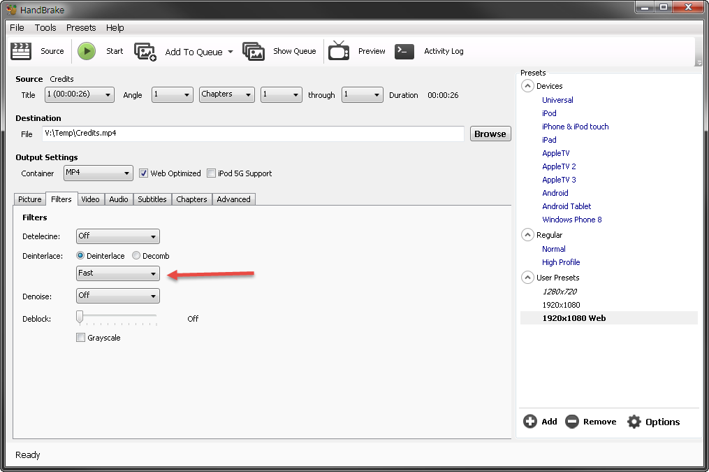

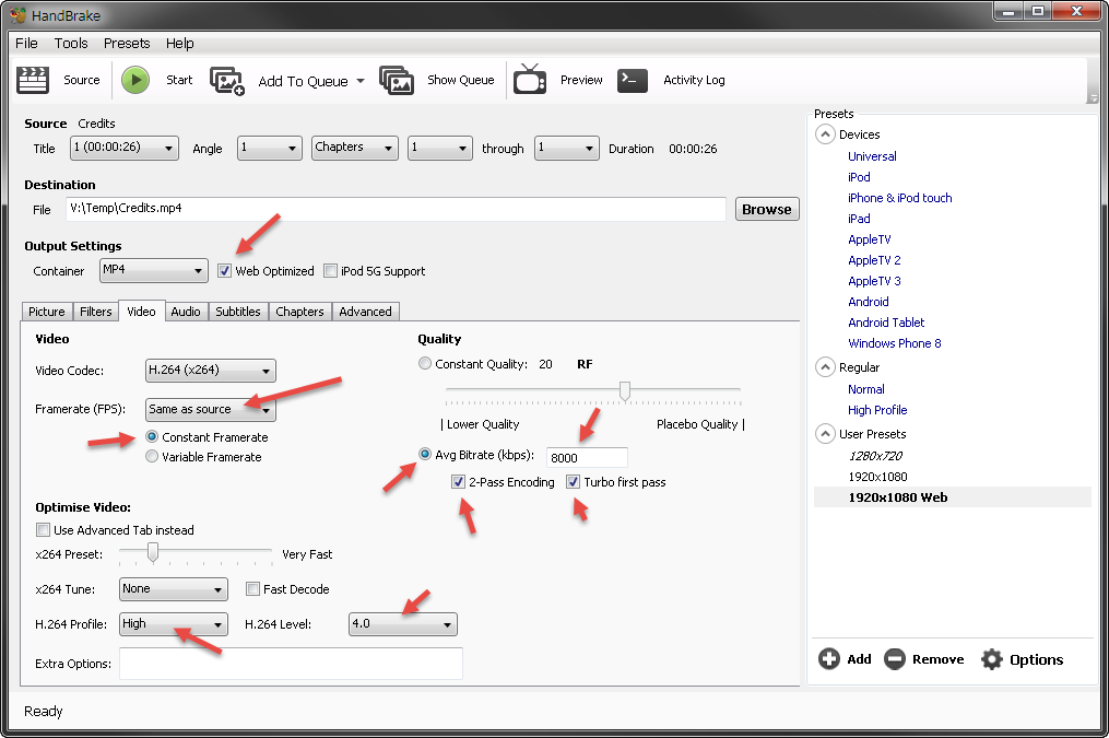

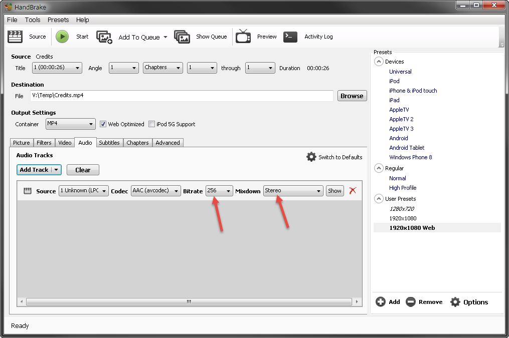

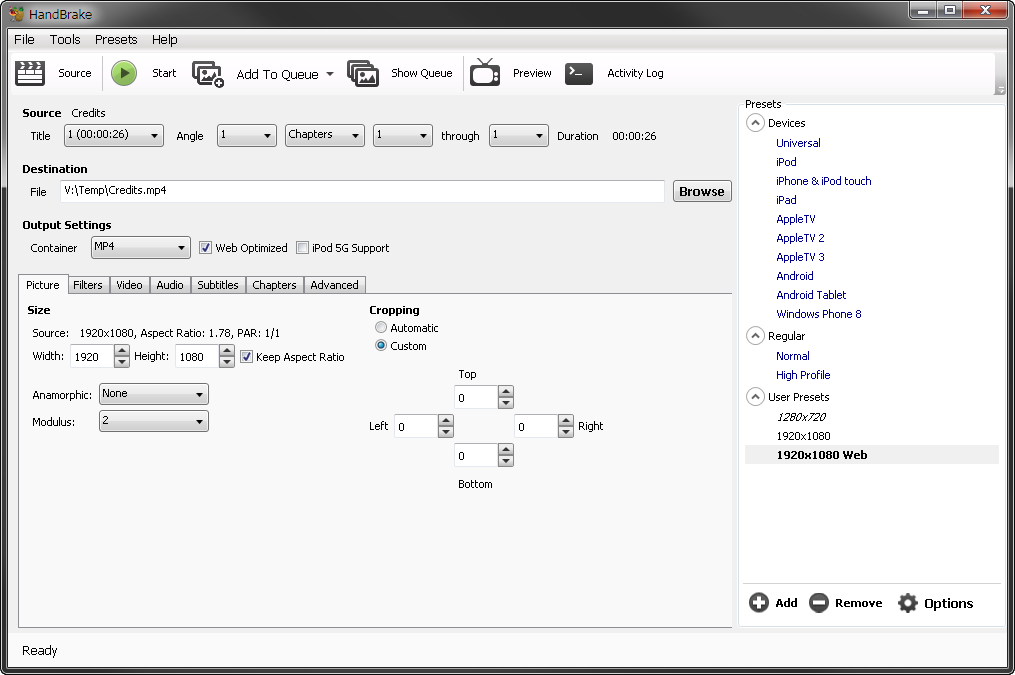

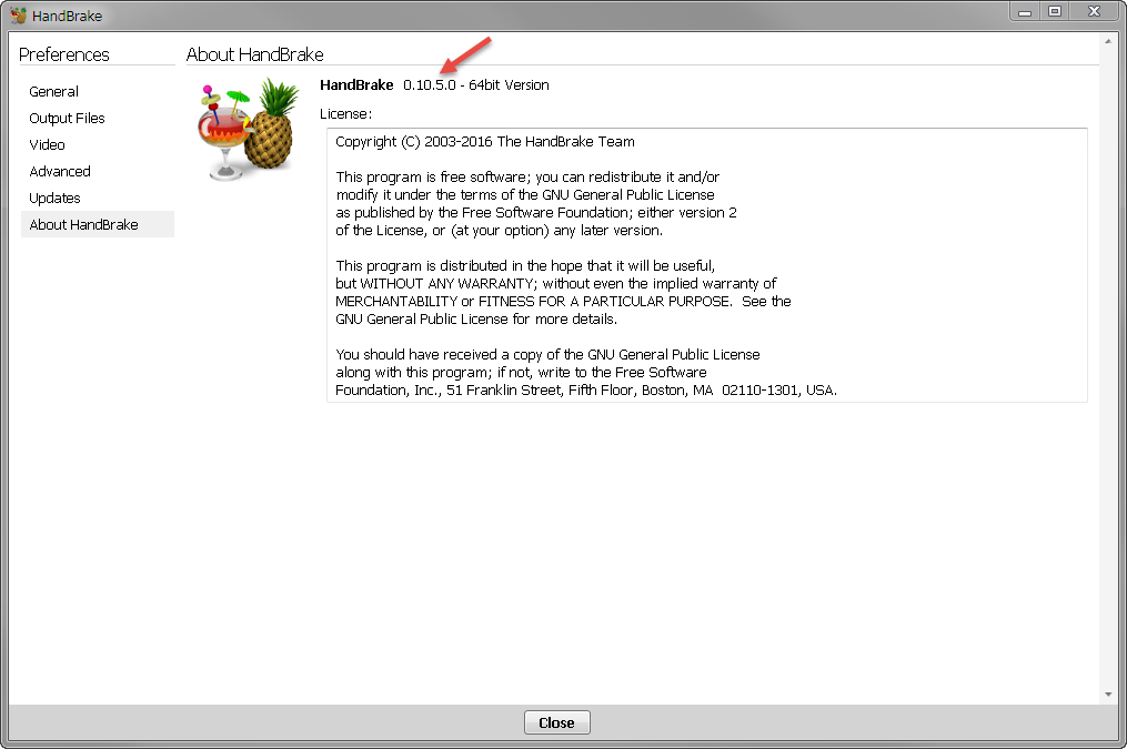

              since your project is upper field first, you won,t be able to export a good progressive file, so export an mp2 HD with 25mbps and wave audio
              then feed this file to Handbrake, use the following previous version, later versions are bloatware (it can be downloaded at various places)
                https://www.videoproductions.com.au/...ogressive5.png

                  Originally posted by Andreas_Gumm
                  Handbrake can read HQ / HQX directly!
                  yes, later versions can, but workflow is way slower
                  example:
                  feeding mpeg2 HD = encoding speed of 220 frames per sec
                  feeding HQX = encoding speed of 100 frames per sec
                  time is money
                  quality is perfect for me
                  if you are feeding UHD, you need to use HQX
