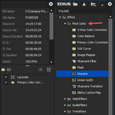

            You can also unlock the effects panel, then create a custom folder called "Most Used" and drag the most used transitions and filters to that folder, then lock the panel again
            see example attached
              Thanks also Anton.
