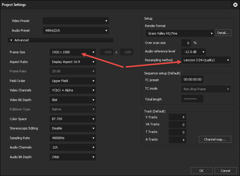

    if Lanczos3 HQ is enabled in the HD project setting, downscale quality is improved when adding 4k clip and exporting
      Frame rate was 25p how do i include Lanczos3 HQ
