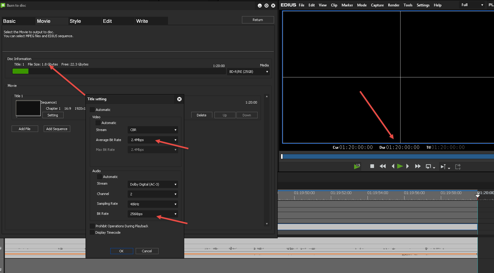

                    here is what I would do:
                    1. mark in and out on 80min timeline
                    2. open diskburner and go to movie tab and reduce video bitrate until total space needed is less than 2GB
                    3. remember the video and audio bitrate value for your mp4 export

                      https://www.videoproductions.com.au/...alculation.png
                      Thats a good tip about using the disk burner to calculate. I personally never use it, as I prefer doing my disc authoring in actual authoring software like Encore, so it never occurred to me to just use it as a calculator for MP4/H264

                          Very, very, very clever Anton. In fact with this method we have an integrated calculation system.
                          Just a question to be more aware... This is for CBR.
                          Can we expect a beter quality result in VBR ?.... and is your method also reliable....
                          In other words, is the codec calculated for BD-R/RE exactly the same then the one stored by MP4 ?
