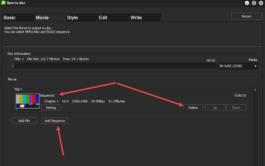

    Hello, I've a strange problem, the Duration between In and Out marker is 0:06:47:22, but after activate Burning to Disk, there's only 00:03 left?

    Can you double check if you have selected the correct sequence for the burn?
      As a very first guess: What about the sequence mark at the very beginning (could it be it is at 00:03?). I would not know why, but maybe this marker is forcing the faulty behaviour...? Delete the mark and try again. Maybe that works.

        Are you sure the right sequence is selected in the burner setup?

          Yes, I'm using the right sequence.

            I had the same issue. But it ended up being because of the sequence
              it means the wrong sequence was loaded in disk burner, 100% guaranteed
                Best "antonvideo" I would like to thank you very much along this road, it's incredible but now it's working again.

                  So it look like you were not using the right sequence after all. Great that you finally checked. :)
                    Thank you, sorry but I did not know I had to change this way. :(
