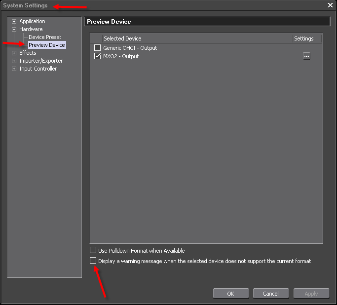

    turn this warning off, it just means you don't have an output card that supports the current resolution

      Thank you very much, now after new start, no message appear.
      I'm curious if my settings are OK, because I can not shutoff "Generic OHCI - Output"
      Click to Enlarge
      James48
        your settings are fine, there is no need to shut off generic ohci and it can't be done unless you add a dedicated output card
        you can use any project size with generic ohci, even UHD and 4k
        the warning is just to inform you that you can't output via firewire when setting anything larger than 1440x1080
