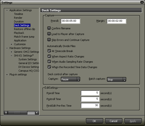

    what are your file divide settings in Edius application settings/deck settings?
    in my case, I have "when the recorded time data changes" ticked
    unticking all, should give you one file, unless the DV tape does not match the project settings
    if DV tape has 32k audio and the project setting is 48k audio, then you can expect problems like that
    location of deck settings

                  Thanks to everibody, and specially to Antonsvideo: his solution is effective!!
                  I have tried it and now I capture just 1 clip at time: it was a just "deck setting" to deselect !....
