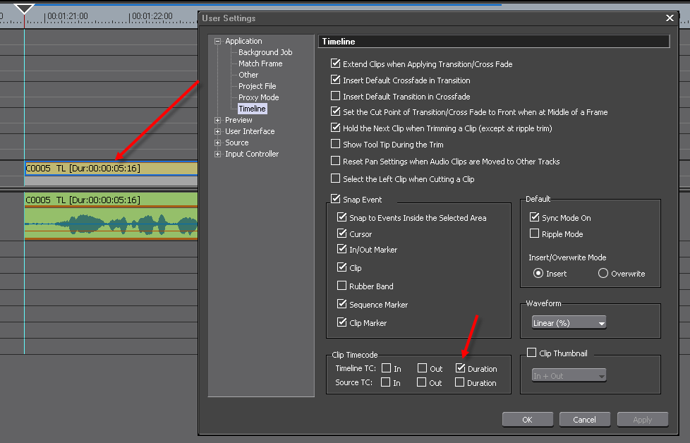

    Is there a quick way to click on a clip and know its length?
    in my case, I don't even need to click, I see it all the time next to the clip name
      I mean a clip that has been cut. The length of that. Without double clicking it. Is there a way to single click, and then hit some keystroke to see the length?
        the info I see is always the correct info, even when I cut the clip or trim the clip, the duration is updated
        are you saying it does not update in your case?
          see what happens when I cut
            Is there some feature that allows me to see that? Here is mine:
              yes there is, did you click the link in post 2? It shows the setting you need to make
                My bad. Thank you!
