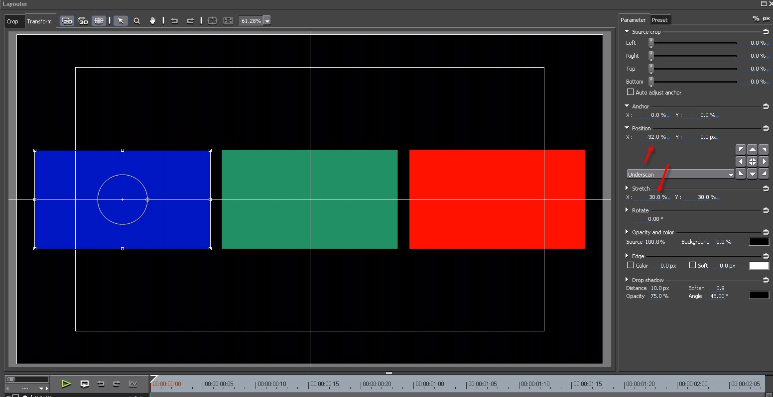

    place clip on V1, open layouter, set layouter on top right to % value
    V1: set to 30% size and set x position 32%
    V2: set to 30% size and leave in default middle position
    V3: set to 30% size and set x position -32%

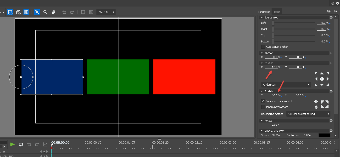

        select the clip on V1 and press F7 to open the layouter or double click layouter in info palette
        if using EDIUS 7.5 and earlier, use 32% x position and -32%
        if using EDIUS 8, use 47% x position and -47% because EDIUS8 calculates strange
        then add the V 2 clip and make the setting
        then add the V3 clip and make the setting
          btw, EDIUS8 also works with the 32 and -32% position, but the EDIUS8 layouter randomly changes the anchor point as seen in my screenshot, once the anchor point is changed to 0%, the 32% position will be accurate
          I will report this
