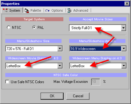

                              you can't mix 4:3 and 16:9 in the same VTS set
                              to make a successfuld 16:9 standard def DVD
                              1. shoot 16:9
                              2. start Edius 16:9 project and capture and edit
                              3. export to DVD ES streams or Program stream and set advanced output aspect to 16:9 (ProCoder advanced settings)
                              4. set DVD authoring software to 16:9 menu aspect
                              5. if your authoring software allows, set option to force 4:3 TV to display letterboxed, this ensures that viewers with 4:3 sets get to see all as intended and viewers with 16:9 TV will see a filled screen
