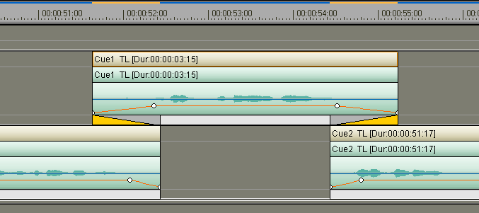

        I prefer to click and add node, then drag down the end to 0
        like seen here
