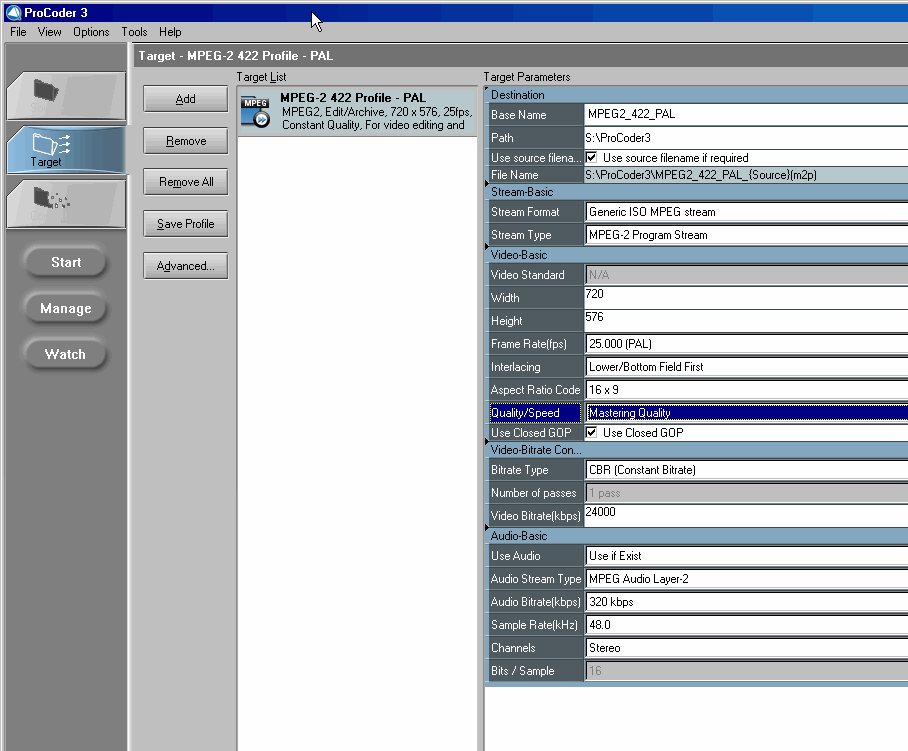

I also found a way to use ProCoder3 to export at 24000kbps and 320kbps audio
use the Mpeg2-422 preset and modify it as seen here
http://www.videoproductions.com.au/edius4/mpeg2-422.gifLast edited by antonsvideo; 10-25-2007, 02:14 PM.Anton Strauss
Originally posted by antonsvideo View PostI also found a way to use ProCoder3 to export at 24000kbps and 320kbps audioGintaras
