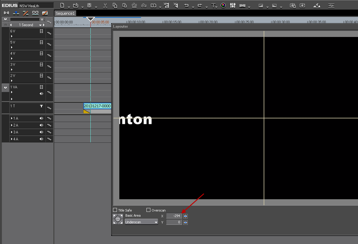

            Fwiw, I too prefer the "T" tracks for the inherent organisational/workflow advantages they offer for basic titling ... it's a shame that the Layouter controls are still second class on those tracks.
            • #21
              can you check the title layouter (as mentioned earlier) and make sure X and Y are set to 0

                    @ Ziggiman. We are unable to reproduce the issue and it seems that a few user I asked are unable to reproduce it. It looks like there may be something in a setting or your system which is causing this odd behavior.
                    There are 2 things which you can try :
                    1 Check the layouter as others have suggested and
                    2 Make a new user profile.
                    Also can we get your OS version is it English or are you using localized?
                    Which font did you use in the titles.
                    Can you please zip a title and upload it?
