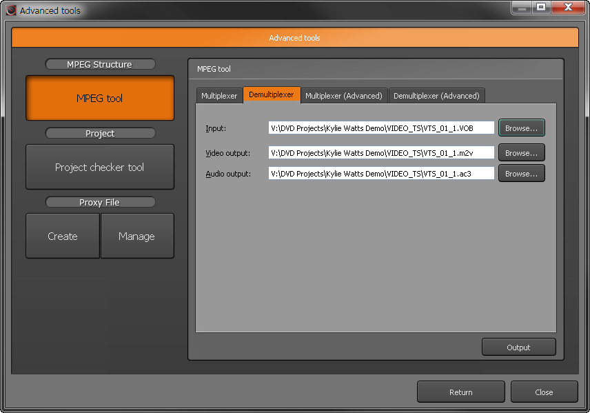

                      one tool that never fails me in disk capture is T5
                      Is there some "Segment Encode" in T5 so I can get an mpeg2 file out of the disk without having to re-encode? (Like in Edius)
                      Gigabyte Z77X-UP4 TH, Intel Core i7 3770k 3.5GHz, 4 Core, 8 Threads, 32GB RAM, NVIDIA GeForce GTX 660 2GB, 500GB SSD HDD for OS, 40TB Usable Hard Drive Capacity, Window 10 PRO 64-bit Edius 9.5 WORKSTATION...
                        to get an mpeg file out of a DVD requires a tool called VOB merge to join all VOB into one, then you can use T5 to demux the VOB into elementary streams, therefore, no encoding takes place at all
                        use advanced tools, mpeg tools, demux
                        when you browse for the VOB, you need to choose all files in browse dialog otherwise T5 won't let you select VOB source files

                            I have not experienced that yet, but I stopped using the source browser to transfer from a DVD to Bin, because it is not reliable in any version EDIUS7
                            100% chance of audio video out of sync and 100% chance of green flashes in video when the DVD was created in a DVD recorder
                            works perfect when using the source wizard in T5 or vob merge and demux
