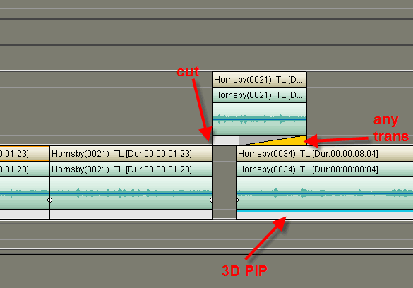

            the way I do this is simple
            I pace the incoming clip on track 2 and add a dissolve at the end to the keyer track (you can also cut the end section of incoming clip and move it to track 2)
            I place the outgoing 3D PIP clip on track 1 with enough overlap for the transition
              antonsvideo
