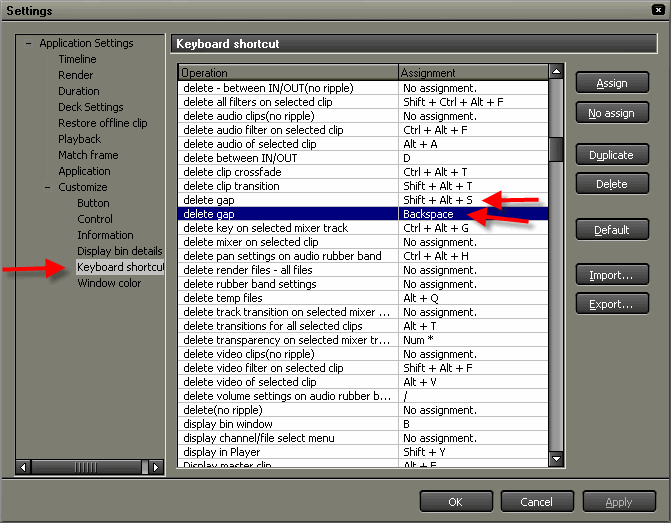

    Alguien sabe como poner un atajo de teclado para "delete gap"?

    Yes its built in "Backspace" or "ALT+SHIFT+S", go to Application settings/customise/keyboard shortcuts for verification or use the help file

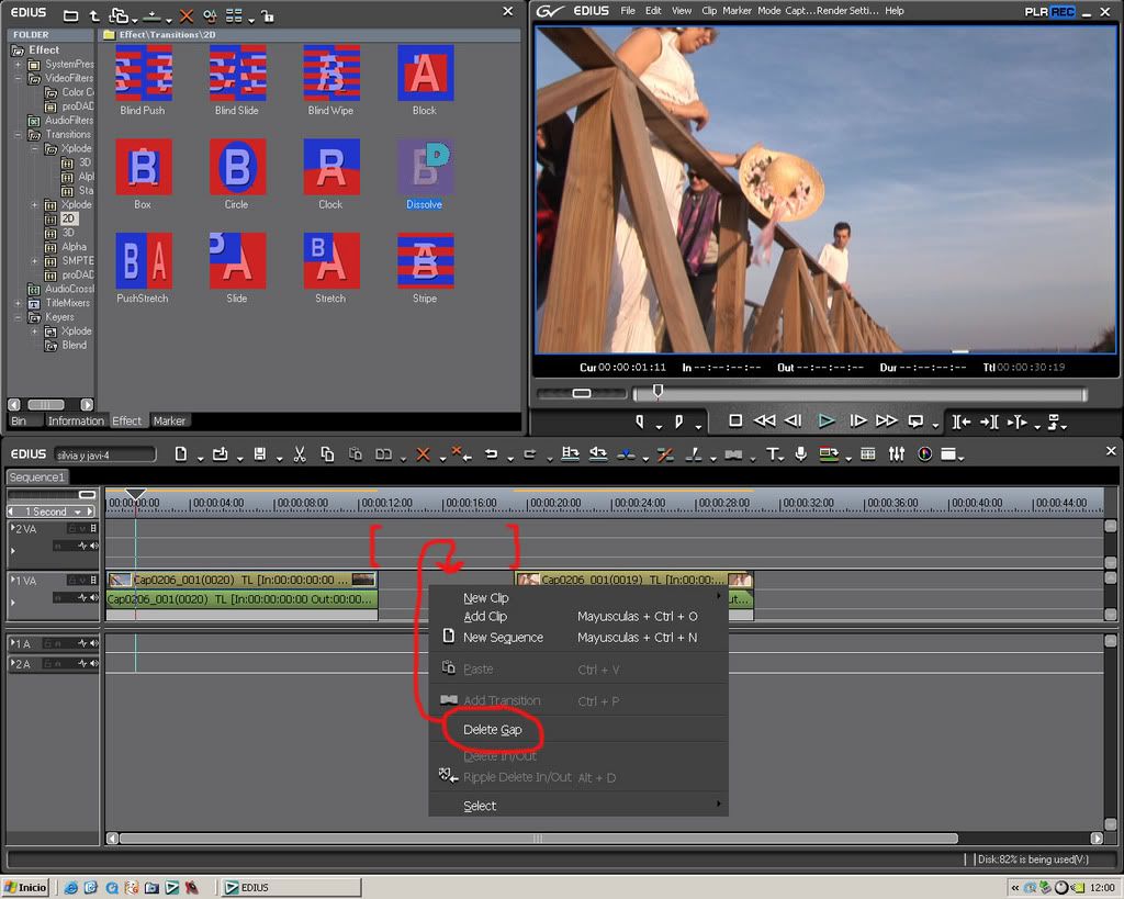

        try this
        start a new test project and add 2 clips to timeline, then create a gap between the 2 clips
        now select the clip on the right of the gap and press backspace on keyboard
        does it work?

                in order to delete a gap, you must select the clip to the right of the gap, then press backspace
                in order to delete all gaps in one hit, select all with Ctrl+A or Shift+A and then press backspace

                  Your wrong it does work.
                  Click in the empty space right click and chose delete gap.
                  Or double click on top of an empty space this will put and in and out over the empty space and press ALT +D

                      You can map the short cut for delete gap, I set mine to G for delete gap.(-:
                        Anton did give you a shortcutkey btw... check his post out again :)
