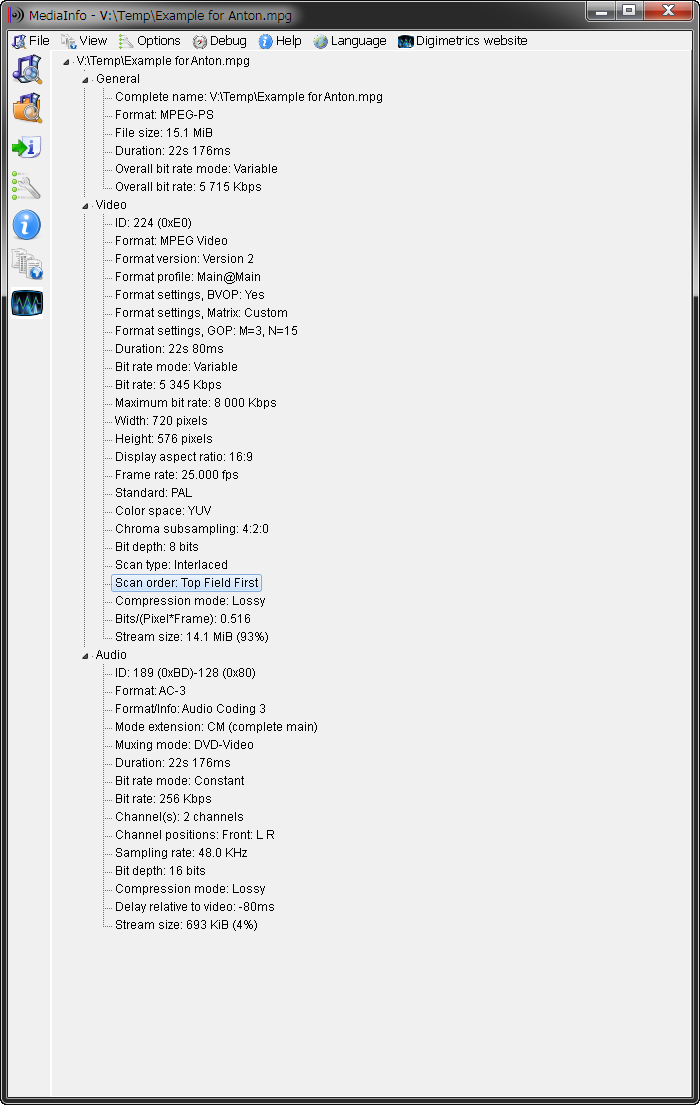

            are these files quicktime based? can you view the properties of such a file with mediainfo (free) in tree view and copy/paste the results
            if they are quicktime based, what version quicktime player do you have installed?
