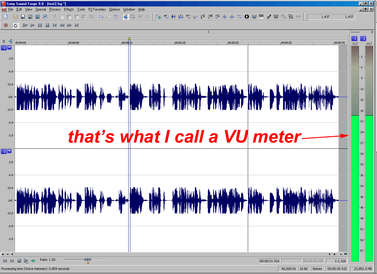

          yes, and Soundfore9 is a great tool, especially the wave hammer, also, SF has the VU meter that I wish in Edius
