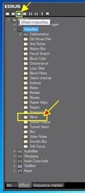

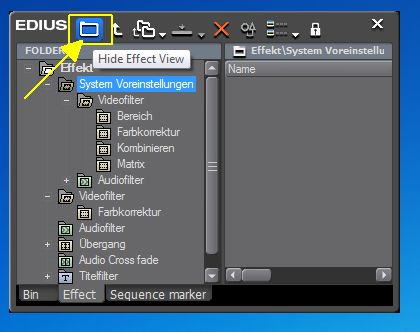

    I am sure you are in the "folder structure view" but with the false marked subgroup
    "folder structure view" looks at where "all" included ... like other applikations or windoof-rules
    there is not ...only the subgroup videofilters displays ...
    go back to the "default view" ==> over the yellow marked button to the default view
    ================================================== =======O
    activate in the line from the yellow marked button,
    the different button's (from left to right) to find all (hidden) effekts
    I self missed in Neo 2.5 a lot of filters, and found for five minutes the way to see it
    okay....dear GV.... you can saying, I am a old idiot...maybe to 50%... the other 50% is Imho on the User Interface-engeneering site

    It sounds like you are in Hidden Folder view. Clcik on the little folder above the Effect Palette window. Central Europe has a screenshot of this in one of the other threads.
