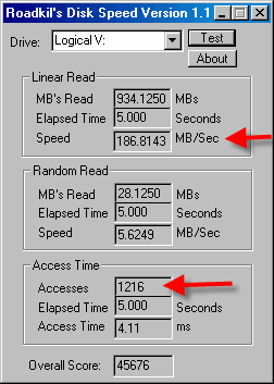

              what are the results of diskspeed on all your drives?

                BTW, disk speed is horrible.

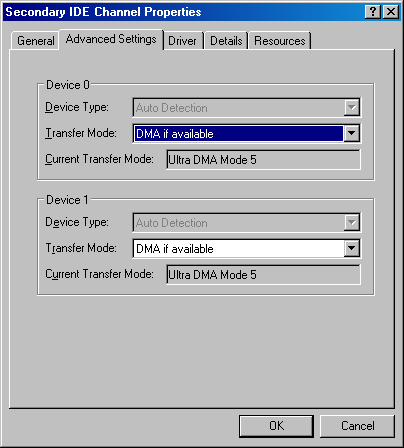

                  Go to Control Panel -> System -> Hardware -> Device Manager -> Disk Drive -> your hard drive(s) -> Properties -> Policies and make sure that Write Caching is enabled.
                  Next, go to IDE/ATAPI Controllers, select each of the channels, go to Properties -> Advanced Settings and see if any of the devices are in PIO mode instead of some DMA mode. If they are, go back to the Device Manager tree, click on the channel (Primary or Secondary), and hit the Delete key to delete it. When this is done, you will need to reboot, and upon restart, Windows will redetect the controller and reinstall the driver. After one more reboot, you should be able to run in DMA mode.
                    write caching is enabled and dma mode selected.
                      it must be DMA5
                        Must is such a strong word.
                        There are other possibilities that are perfectly acceptable or even preferable -- Ultra DMA Mode 4 is certainly usable for video capture, and Ultra DMA Mode 6 (ATA 133) is faster than Mode 5.
