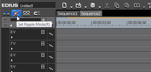

    Turn ripple off and sync on.

        also, look at the mode bar for quickly switching ripple on and off
        for best results, keep it off for good

          I have done it. It works. I appreciate your timely and prompt solution which was causing me a lot of headache

          Thank you antonsvideo,
          I appreciate the excellent visual help
          Visual ones are always very good on my eyes
