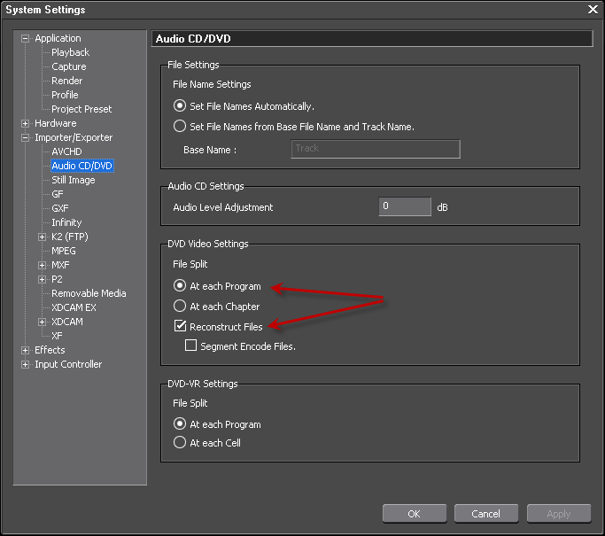

    1. update to latest version (free), 6.02 is buggy
    2. set as seen http://www.videoproductions.com.au/e...VDcapture2.png

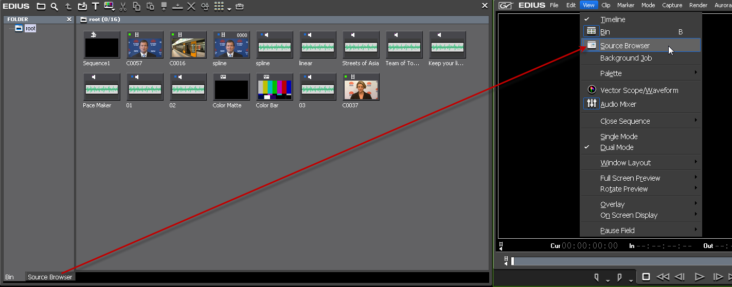

    3. use EDIUS Source Browser to go to DVD drive, then right click and transfer to bin
      using source browser
