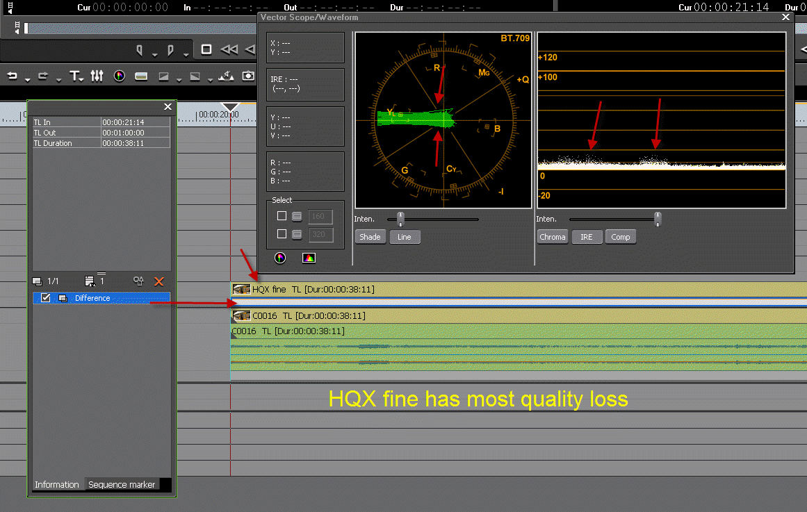

    I use HQ Fine, it gives a cleaner result than HQX fine, can be easily verified with difference keyer
    HQX super fine gives a better result than HQ fine, but file size will be double

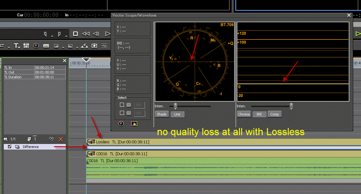

      and then there is Canopus Lossless, where there is 0.0000% quality loss, much better than HQX super fine
              http://www.videoproductions.com.au/e...ne-quality.png
              This what you see in vectroscope is just a some "interpretation" of the difference- look at the picture, to see what is exactly different. You need to zoom a lot for Super Fine to see this difference- it's very high quality mode (almost lossless).
              One difference- Lossless works in both RGB and 4:2:2 mode- HQX is always 4:2:2.
