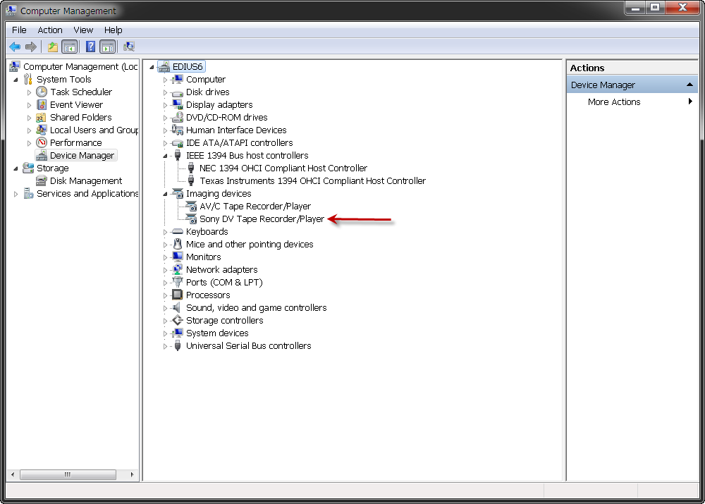

              do you hear any PC noise when you connect the Sony
              does the Sony appear in device manager as an imaging device after connecting?
              • #22
                do you hear any PC noise when you connect the Sony ]
                Yes, for 2 cam.
                http://www.videoproductions.com.au/e...ing-device.png
                Neither for Canon A1, nor for Sony.
                Only the generic line.
                Marc
