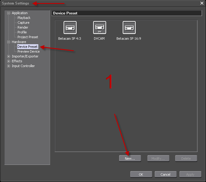

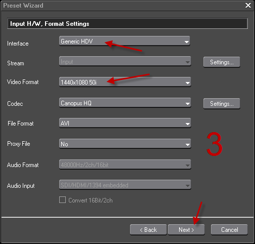

                  something must be wrong with your device preset
                  example, a 1440x1080 50i HDV device preset will not capture anything other than that
                  so, make sure the camera recording is actually the same as the device preset, similar to this

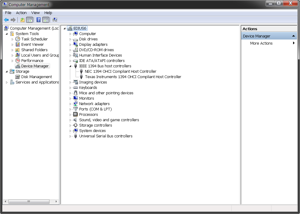

                      can I see a screenshot of your IEEE1394 in device manager, in expanded view
                        See the picture
                        There is no : VIA OHCI IEEE1394 Compliant Host controller.
                        But, with the mobo : Asus P5K-E , perhaps it's not compatible.
                        Marc
                        System : W7 Ultimate - MB: Asus Z170 - I7 6700K - Ram 16 Go - SSD1 256 Go (OS/log) - SSD2 1To (rushes) - HDD 4To (save) - Nvidia Asus GTX970 - HDspark - Edius WG 9 - Vistitle 2.6 - Robuskey - Mercalli4 - Neat video - Ignite - Hitfilm4Pro - AV : Eset Nod32 - Others : Moniteur Sony 32-EX500 - Cam : Sony EX1-R - 2 x Sony PXW-X70 - 1 x Pana GH5
                        Edius in France
                          have a look what other drive is included
                            Yes I would like add a new controller , but it's refused (or not found)
                            On my personnal machine I have this ones on picture
                            How to transfer from a machine to another ?
                            Marc
                            Edius in France
                              is this an onboard firewire? I mean part of the motherboard?
                              if so, some are problematic
                              in that case, go to PC shop and buy a firewire card, very cheap and it should work
                              but the one on the NX should work as well, and if the NX is installed correctly and with the EDIUS hardware driver from EDIUS 6.05 then you should see the NEC and Texas instrument driver, at least this is what I see whenever I do it
