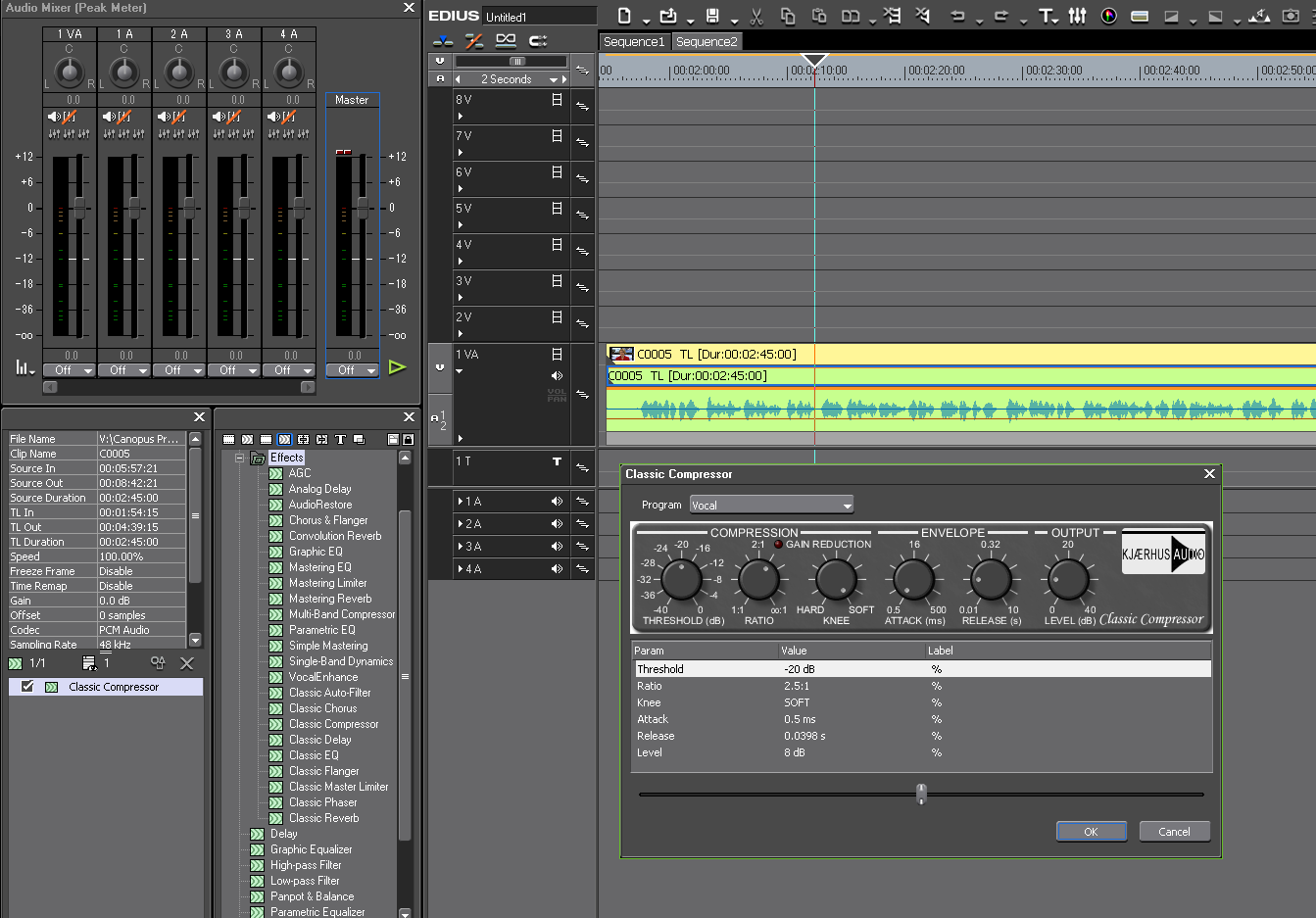

    First Crash of EDIUS 6.05 for me
    Happened Whilst I had the Classic Compressor Free VST by KJAERHUS AUDIO
    open and was trying some different settings from the pull down preset bar in the compressor. I also had the Audio Mixer Open to monitor the levels and the crash occurred as I clicked the mouse pointer on the time line to switch back to an earlier postion in the time line whilst it was playing.
    EDIUS HAS STOPPED WORKING CLICK CLOSE
    after this I restart then recover from the auto save and resave my project.
    Next I go back and do the same as before only this time no crash.
    I have exported the project to disc and it works ok, along with the vst on the audio also worked fine.

      I notice in these ones that Fault Module Name: Classic Compressor.dll_unloaded
      where as the first one was Fault Module Name: USER32.dll
      The last 2 crashed occurred when I was in EDIUS 6.05 and switching back and fro from EDIUS to the Windows Desktop.

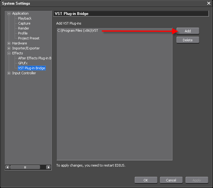

                  thanks for that, it works perfect in Win7/64 using EDIUS 6.05
                  I installed the exe, this created a VST folder in program files 86
                  then I started EDIUS and went to system settings and added the VST folder from the VST bridge
                  then restarted EDIUS and all of them show up now and work without a crash so far
