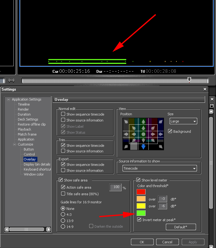

    also, place the VU meter on preview mon and you won't need the audio mixer
    also, customize to make the default cyan of the vu meter green so it looks more realistic
