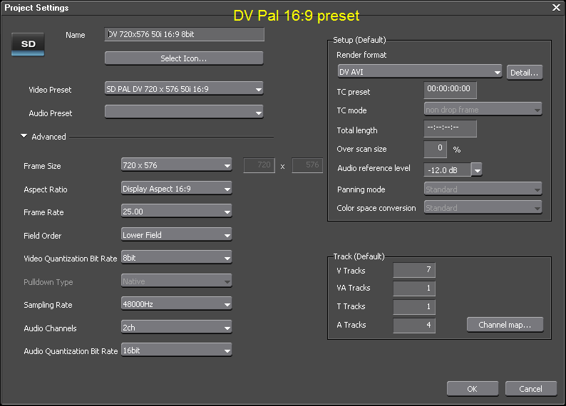

Hi, i've shot with a Canon XL2, and recorded on a Focus FS-100 Portable DTE Recorder, 16:9, 50i, lower field. I have transferred the files into my computer. Settings are shown like in the picture bellow(Edius 6.02). I have analyzed the files with GSpot, and it shows that the clips are 16:9. I don't understand why Edius convert the clips to 3:4 when i bring them in Bin. Or, maybe i have to do some settings? I have tested with PPro and Vegas, and they both import my files in 16:9 without any problem. Thanks.

also, your project setting seems strange for DV, does it really have 8 audio channels embedded?Anton Strauss
Originally posted by vecinu View PostWould you explain me, please, which are correct settings for SD-PAL DV and where i am wrong?
Thank you.
proper DV is stereo 16bit 48k 2 channel
consumer DV preset also often is 12bit 32k 4 channel (avoid this one)
also, you are using 24bit audio (EDIUS should not allow this under a DV preset), DV is 16bit
see attached correct Pal DV preset

however, when choosing a DV preset in the dropdown, it should default to the DV spec, but it does not
currently, the only way to get it to DV spec is by using the WizardAnton Strauss
Which is why we have the wizard. If you don't know in the outs use the wizard.
As soon as you are in the advanced settings you take responsibility for the configuration.
That's where the Free format is. The drop down in the advanced section is just an easy frame size selection not an "in spec wizard".Last edited by GrassValley_SL; 09-14-2011, 04:17 AM.
