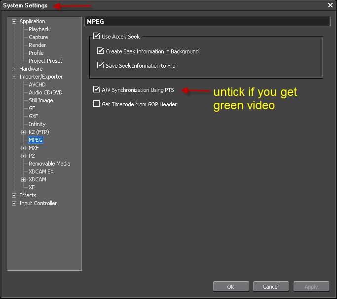

    there are options in system settings/importer exporter/CD DVD
    try unticking the PTS option or ticking it if unticked
      Thanks. So I'm assuming you mean the PTS box in the MPEG hierarchy. It was not checked so I checked it. Same results.
