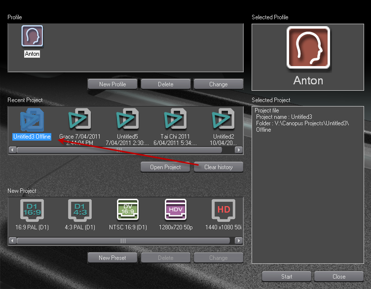

    do you mean the recent project list in the startup window? you can clear them easy with right click
      thx - but if Edius wants to start with a last project and this project is broken, I get no acces to the "virgin" start window of Edius.
        Edius does not autostart with anything, it will only start with whatever you select in the startup screen
        in the startup screen, you can remove all offline projects with clear history
          I bet you (with 30 years of editing experience) that my Edius 5.5 shows no starting screen again after having tried to load one of these problematic projects, but pops up with the little window in the middle of the screen and then nothing happens any more. That is why I would like to know where I can dig out the file with Edius's starting parameters to erase the project name there.
