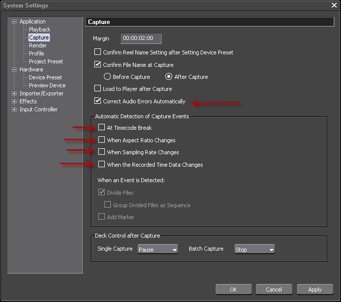

      My other "Automatic Detection of Capture Events" are already set like this:
      At Timecode Break - CHECKED
      When Aspect Ratio Changes - CHECKED
      When Sampling Rate Changes - CHECKED
      When the Recorded Time Data Changes - CHECKED
      then...
      "When an Event is Detected" the "Add Marker" is CHECKED and "Divide Files is UNCHECKED.
        everything you have CHECKED needs to be UNCHECKED

        in E5, CHECK skip errors and continue capture
          I thought so too...but I tried that before and the same happens. Actually if I uncheck everything the entire section of the setup gets disabled and I cannot anymore do anything to "When Event is Detected" section.
          I'm on Edius 6. It is so not clear in the documentation.
            here are the settings you need to get a continuous file

              I tried exactly same settings for Edius with no luck. I was not using the legacy driver... I changed that and try again later since I cannot reboot my machine at this point. I post the result... Thanks for your suggestions.
                technically speaking, the new option to add markers at file problems should work but it appears capture stops instead
