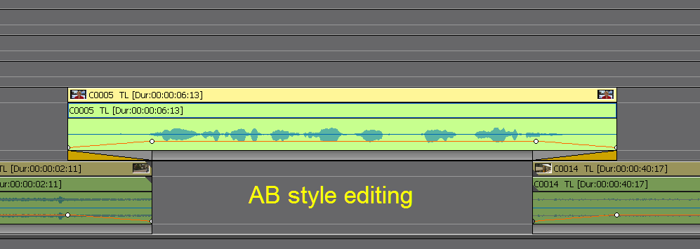

            I already explained, untick the very first option in application settings, then you don't need to trim
            or use AB style editing like I do
