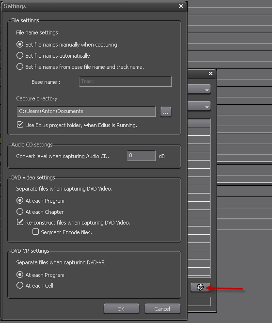

    have a look at the mpeg importer settings under plugin settings, if use PTS is seleted, deselect and capture again, if it is not selected, select it and capture again
    also, make sure disk capture settings look like this
      Great, thanks Anton, I have tweaked those and will give it another try later. FYI "Don't use PTS" was unticked.
        in my case it is also unticked
        but sometimes, depending on DVD quality, you may need to tick it
        but first check the other settings as well
          Great, that did the trick thanks, looks like PTS was the issue.
            http://www.videoproductions.com.au/e...e-settings.png
            I've always noticed that those settings seem to help, and I've always checked the "Segment Encode" as well. Any idea what this does (the manual isn't exactly clear) and is it harming or helping. I think it is supposed to save time when using the "Re-Constuct" option if I'm not mistaken.
            Can you confirm and/or clarify this? Thanks! (I'll probably just do some analog captures for this next project anyway though, since they want 2 second clips here and there from about 10 different DVD's, lol.)
