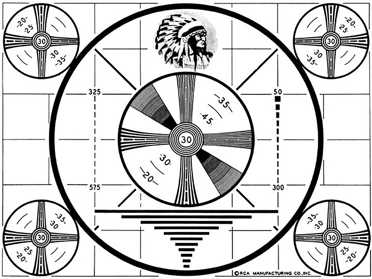

also, place my resolution chart on your timeline and see what vertical resolution your monitor is capable of
http://www.videoproductions.com.au/e...Resolution.jpg
anything below 400 lines would be badAnton Strauss
